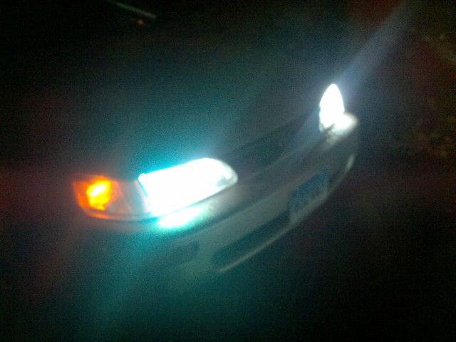

              its a small square bar...
              its like 16 led lights in a square....cant really tell it shows up better during the day i hope (lol)
              HID and Led Lamp On...
