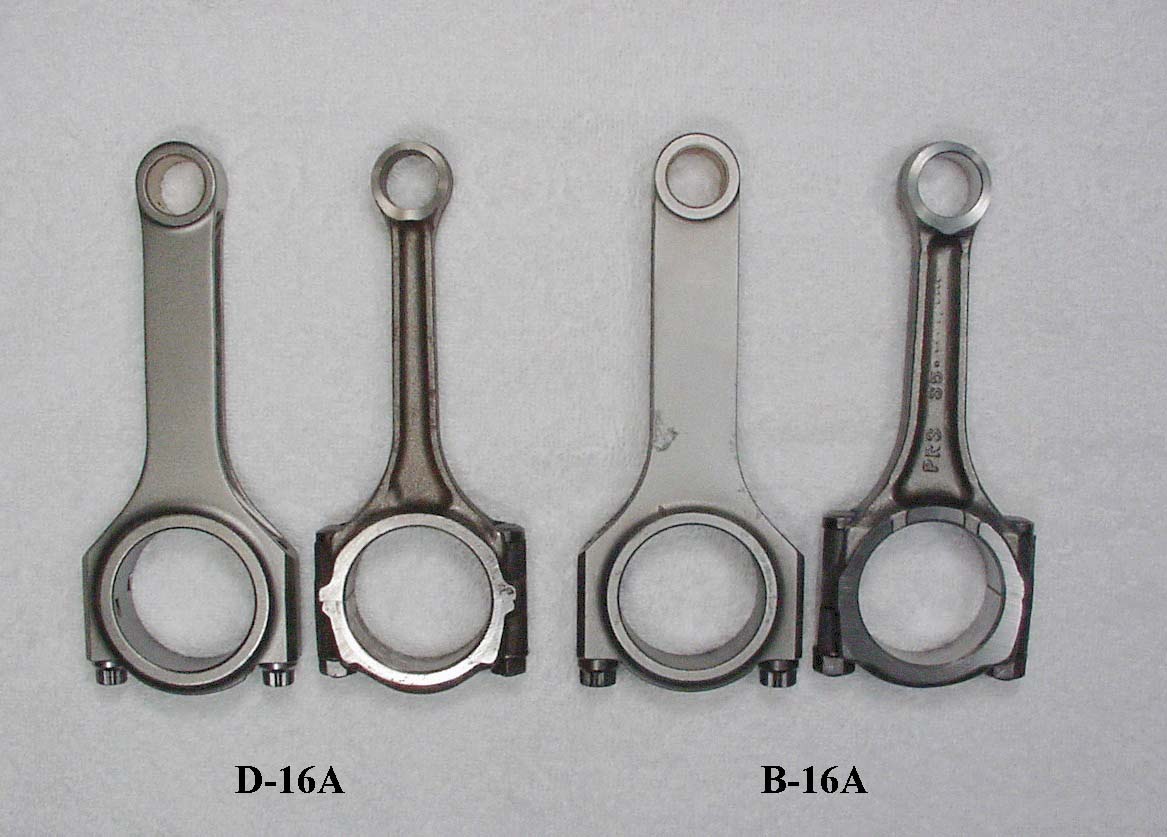

              ^^^^No. D16 rods are good for up to 200hp. If you look at a d16 rod compared to b series theyre alot weaker. Heres a pic for comparison http://www.theoldone.com/articles/xm...6_n_B16A_2.jpg Yes ls rods work with some work needed but youd need arp bolts for anything near 300+hp. Rods arent expensive just get some eagles.

                true. will i have to do any notching to my block for h beams?
                  I dont beleive so. What kind of numbers are you shooting for? What are you doing for pistons? Maybe look into a vitara piston custom rod setup from fj distributors, relatively cheap and vitaras have been proven to hold 400+

                        I hear ya on not wanting cheap but vitaras are cheap and proven to hold well over 300hp. The only problem is with regular H-beams they sit a little in the block lowering compression. Custom FJ I-Beam rods from FJDistributors fix that problem. http://fjdistributors.com/product_in...roducts_id=285
                        Does require some notching on d16s for those rods.
                        As for notching the block for H beams, did some research and the answer is yes. But personally I think you should really consider that fj I beam/vitara combo. Save some money and use it elsewhere on the build. Vitaras are proven to hold just as much hp as stock sleeves on a D. http://www.honda-tech.com/showthread...ghlight=vitara
